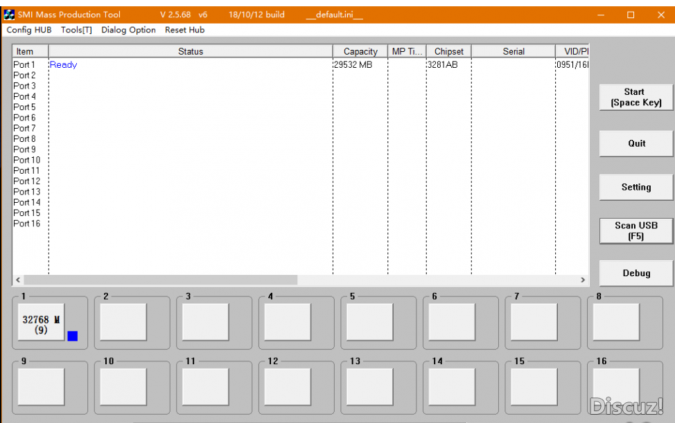

因为慧荣SM3281主控的U盘性能优异,但目前有的量产工具支持的闪存比较少,手上有几块镁光NW702(L95B)闪存,但不支持,所以想办法让量产工具识别此闪存,方法如下
  NW702双贴需要移动跳线电阻(主控边上一横一竖),拆掉SB4(默认有),SB8(默认没有)
先下载:SM3281AB_R1019 正片工具
使用文本编辑器打开UFD_ALL_DBF\flash_3281AB.dbf,任意位置添加标红的那一行数据
//----------Micron-----------------------------------------------------------------------------------------------
@ 2C A4 64 32 AA 04 01 01 03 00 00 00 00 5A 5A 5A 84 3C 00 00 00 00 32 64 A8 84 84 B2 B2 B2 5D 5D 5D 66 66 22 DB // Micron MT29F256G08CBCBB O0915 3D MLC L06
@ 2C A4 08 32 A1 00 01 01 03 00 00 00 00 5A 6C 6C 84 3C 00 00 00 00 32 64 A8 84 84 B2 B2 B2 5D 5D 5D 66 66 22 DB // Micron MT29F256G08EBHAFES Q0110 3D TLC B16A
@ 2C A4 88 32 A1 00 01 01 03 00 00 00 00 5A 6C 6C 84 3C 00 00 00 00 32 64 A8 84 84 B2 B2 B2 5D 5D 5D 66 66 22 DB // Micron MT29F256G08EBHAFES R0801 3D TLC B16A
@ 2C C4 08 32 A6 00 01 01 03 00 00 00 00 5A 6C 6C 84 3C 00 00 00 00 32 64 A8 84 84 B2 B2 B2 5D 5D 5D 66 66 22 DB // Micron MT29F512G08EBHAF R0409 3D TLC B17A
@ 2C C4 08 32 A2 00 01 01 03 00 00 00 00 5A 6C 6C 84 3C 00 00 00 00 32 64 A8 84 84 B2 B2 B2 5D 5D 5D 66 66 22 DB // Micron MT29F512G08EBHBF R0801 3D TLC B27A
@ 2C C4 18 32 A2 00 01 01 03 00 00 00 00 5A 6C 6C 84 3C 00 00 00 00 32 64 A8 84 84 B2 B2 B2 5D 5D 5D 66 66 22 DB // Micron MT29F512G08EBHBF R0806 3D TLC B27A
@ 2C D4 0C 32 AA 00 01 01 01 00 00 00 00 5A 6C 6C 84 3C 00 00 00 00 32 64 A8 84 84 B2 B2 B2 5D 5D 5D 66 66 22 DB // Micron MT29F512G08EBHAF R0703 QLC N18
@ 2C 84 64 3C A9 04 01 01 03 00 00 00 00 5A 6C 6C 84 3C 00 00 00 00 32 64 A8 84 84 B2 B2 B2 5D 5D 5D 66 66 22 DB // Micron MT29F256G08EBHAFES Q0110 MLC L85C
@ 2C 84 64 54 A9 00 01 01 03 00 00 00 00 5A 6C 6C 84 3C 00 00 00 00 32 64 A8 84 84 B2 B2 B2 5D 5D 5D 66 66 22 DB // Micron MT29F128G08CBCCB M0815 16nm MLC L95B
接着打开UFD_ALL_ForceFW\SM3281AB.FFW,添加标红数据
[ForceFW]
FLASH_ALL_PTIF=0
FLASH_2C846454A900_ISP=SM3281AB_ISP_MLC_L85c.BIN
FLASH_2C846454A900_PTEST=PT.bin
FLASH_2C846454A900_BootCode=BootCode.bin
然后就可以打开量产工具按照正常步骤量产了,量产后的U盘速度还是不错的。
